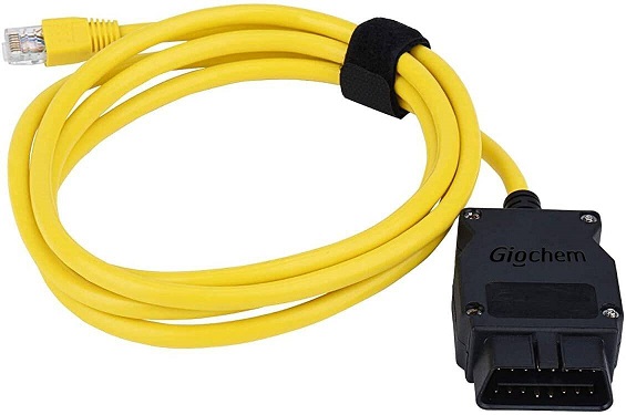

To connect VTool to a car (only SPA/CMA platforms are supported), an OBD to Ethernet adapter is required.
Original Volvo VOE (Volvo OBD to Ethernet) Adapter 9513108 + UTP/FTP/STP cable to LAN port
Or any no-name adapter
If the computer does not have a LAN (ethernet) port, a USB Ethernet adapter is required
After connection, the network devices of the car and the computer need about 20 seconds to establish a connection, so VTool does not communicate with the car immediately.
