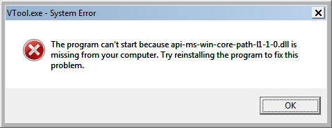

3) Not required starting from v 1.2.210, but if you notice the following error after launching VTool under Win7:
This problem can be solved by unpacking the archive https://vtool.info/blend/api-ms-win-cor ... l1-1-0.zip
into the Windows system folder ( C:\Windows\System32 )
Then VTool should launch without any issues.
