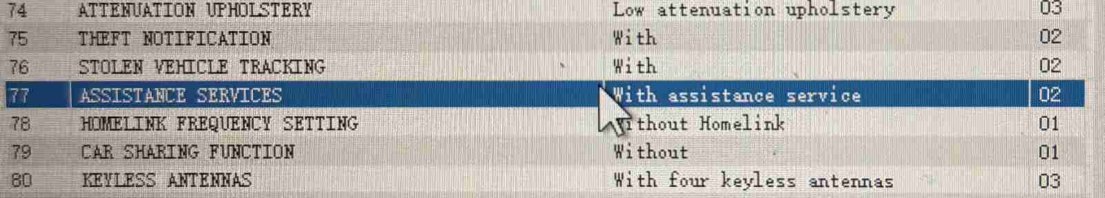

i try to configure the parameter of 77 as below, but seems it can only show the current status, and no area to click to update the parameter? any advice?
