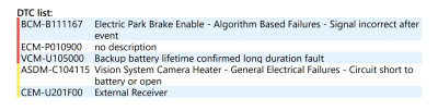

Hi everyone, I used vtool today and I got the following codes. Does anyone know what they mean or what the fix is please? I have googled them but not found definitive answers to some of them.

Here is what I found in Vida
BCM-B111167 Electric park brake enable. Algorithm Based Failures. Signal incorrect after event
Information
The Brake Control Module (BCM) monitors the requested action of the caliper motors, parking brake.
Test run criteria
The control module's test for the DTC starts when:
• The vehicle is in usage mode active or higher.
Detection criteria
The DTC is set if the control module detects that:
• The brake caliper motors, parking brake, do not reach the target state for a requested action within an allowed time.
Fault handling in the control module
None.
ASDM-C104115 Vision System Camera Heater. General Electrical Failures. Circuit short to battery or open
Information
The Active Safety Domain Master (ASDM) monitors the road in front of the vehicle. The control module has a built in radar and camera. The ASDM camera heater is used to heat the windshield in front of the camera and the radar to reduce the risk of condensation blocking the view.
Test run criteria
• The vehicle is in usage mode active or driving.
Detection criteria
• The circuit is open or short-circuited to battery voltage.
The ASDM camera heater is disabled.
CEM-U201F00 External receiver.
Information
The Central Electronic Module (CEM) receives external data from the Multiband Antenna Module (MAM).
Test run criteria
• The vehicle is in usage mode active.
Detection criteria
• The Multiband Antenna Module (MAM) is not responding or is sending an invalid response.
None.
VCM-U105000 is a known issue. You need to visit a dealer and load SW to reset the battery lifetime counter in VCM. For this routine VCM PIN11 is required which is unique. So can't be done easily via tools like VTool. Details: https://static.nhtsa.gov/odi/tsbs/2024/ ... 8-0001.pdf
ECM one is missed in Vida as well
